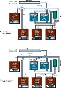

In this case, the plant was running four 100-hp lubricant-cooled rotary screw compressors under modulating control. It was losing productive capacity because a 20-psi pressure drop made it impossible to maintain the required minimum 90 psig in the header.
The piping schematic in Figure 5a shows the original piping and Figure 5b shows its modification. Four 100-hp 490-cfm oil-cooled rotary screw compressors delivered air to a six-inch main header. The velocity in the four-inch interconnecting piping was as follows:
  • 13.2 fps @ 490 cfm.
  • 26.4 fps @ 980 cfm.
  • 39.6 fps @ 1,470 cfm.
  • 47.4 fps @ 1,760 cfm.
Four crossing tees added turbulence at these velocities. The total pressure loss with all machines at full load was 20 psig. When demand increased, the pressure in the main fell below 90 psig, shutting down production.
Two changes solved the problem. First, the four-inch crossing tees were changed to directional angle entry. The pressure drop fell to six psi and the main system now receives 104 psig that is easily regulated to a steady 90 psig. The connections were prefabricated and installed during a one-day maintenance shutdown at a cost of $4,200. This eliminated the production interruptions that had occurred for 20 years. Second, the compressor discharge pressure was reduced to 98 psig, which represents a power saving of six percent, equivalent to about $9,585 annually.
