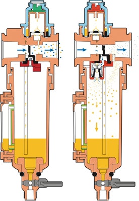

Figure 1. Two types of aerosol methods — high delivery systems (oil-fog) and low delivery systems (micro-fog) — can be used for lubricating compressed air equipment.
There are two types of aerosol methods — high delivery systems (oil-fog) and low delivery systems (micro-fog) — for lubricating compressed air equipment (Figure 1).
Pneumatic systems requiring heavy lubrication, such as a single air tool or a single cylinder, benefit from oil-fog delivery systems. However, in this high delivery system, the oil aerosol produced contains relatively large oil particles, which are affected by gravity, making this system unsuitable for lubricating a device at a higher level than itself or at a distance away. As a general rule, the maximum distance this type of lubricator should be placed from the device it is to service is 9 m, at the same or a slightly higher level.
With low delivery or micro-fog systems, the airborne aerosol contains only light particles, less than about 2 µm diameter, meaning they can not only travel uphill but also for longer distances and through more complex feed lines without wetting out in the pipe. This system type can also ensure even distribution through multiple lubrication outlets, making it ideal for multiple valve control circuits. The smaller particle size makes low delivery systems most suited to applications where very small amounts of lubricant are required.
Both system types include a non-return valve in the siphon tube to ensure immediate lubrication as soon as the air supply is turned on. However, for some rapidly cycling applications or systems with small stroke cylinders, it is sometimes impossible to lubricate correctly with these conventional lubricators. Here, system modifications such as quick exhaust valves or a suitably located bi-directional lubricator must be employed.
Most aerosol lubricators are constant density devices, meaning once the drip rate is set for a given flow, then the amount of oil delivered will also change in direct proportion to any changes in flow rate. This prevents over- or under-lubrication to ensure even wear and minimum energy loss.
