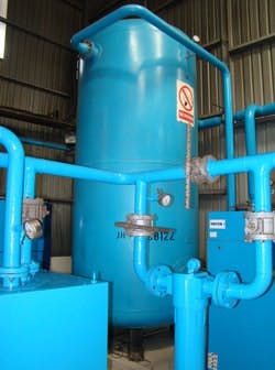

The storage of compressed air in receiver tanks is very important to consider when excellent system energy efficiency is the goal. Among other things, compressed air that is stored in system air receivers can be used to increase the efficiency of the running air compressors and to help stabilize system pressure so lower average pressures can be used. It also can help the system to ride out large compressed air demands or major system events that might cause transient low pressure issues.
How much storage capacity does a system need? This is a common question and is typically subject to a number of different industry rules of thumb. Led by the efforts and recommendations of Compressed Air Challenge, many in the industry are now recommending a storage capacity of between 5 and 10 gallons per cfm for compressed air systems. Applying these sizes reduces the compressor cycle frequency substantially and saves significant power.

Before discussing the improvement of pressure stability that goes hand-in-hand with larger storage capacity, let's go through a storage capacity primer. Let’s say you have purchased a large storage tank and it is sitting unpressurized out on the pad. How much air does it contain? If it is a 1,060 gallon receiver it will contain 1,060 gallons of atmospheric air pressurized to the local atmospheric pressure (14.5 psi above absolute zero for example). Since every 7.48 gallons contains one cubic foot, that receiver contains about 142 cubic feet (cf) of ambient air.
If one more atmosphere of air pressure is added to the receiver–assumed here to be 14.5 psi absolute–or another 142 cf, the pressure in the receiver will rise by 14.5 psi. This continues as more air is added to the receiver with each 142 cf (1,060 gallons) adding another 14.5 psi.
Figure 2. Many in the industry are now recommending a storage capacity of between 5 and 10 gallons per cfm for compressed air systems.
If you want to determine how much air to add in order to boost the pressure in the tank by 1 psi, simply divide 142 cf by 14.5 psi, with the result yielding 9.78 cf/psi. This number is important, because it indicates how much the pressure will change in the tank if a certain amount of compressed air is added or removed from the storage tank.
For example, if a compressed air powered machine uses 97.8 cf more than the compressor could produce, this air must be supplied by the receiver. For the tank in question, the pressure in the storage tank would drop 97.8 cf divided by the 9.78 cf/psi capacity of the storage receiver (i.e., 10 psi) during that event if all the air came from the tank storage. If the tank size was doubled, then the pressure would drop only 5 psi, and if tripled only 3 psi, and so on. This shows that if we desire pressure stability, and the compressed air system has high transient demands, then the way to protect production machinery from low pressure is often to add more storage.
