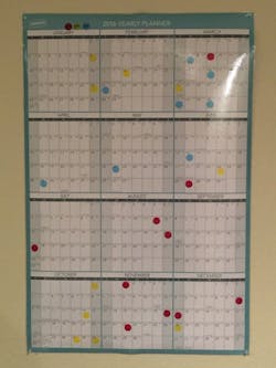

We began the project by determining the overall mean time between failure (MTBF) at the plant. Using plant failure data and completing a Crow/AMSAA Reliability Growth model, we were able to determine that MTBF was averaging approximately 14 days. Few on the team thought this data was surprising or unnerving: They were so numb to all the failures that they hadn’t realized the circle of despair that had become the new norm. However, the reality of the MTBF data also presented us with a challenge to make a difference in how the plant was operated and maintained.
After admitting we had a problem, the next step was to determine how bad the problem really was. With the work of a few great individuals we pulled the failure data for the past three years and charted the dates on a simple wall calendar purchased from the local office products store (Figure 1). We color-coded the corresponding events and dates for each year and then posted the process flow diagrams (PFDs) of the plant on the wall, adding a colored dot to where each failure had occurred (Figure 2). The reason for this was to identify where the actual failures took place and the corresponding work orders that were written to make the repairs.
Figure 1. Charting equipment breakdowns through time can help make failure patterns more visible.
