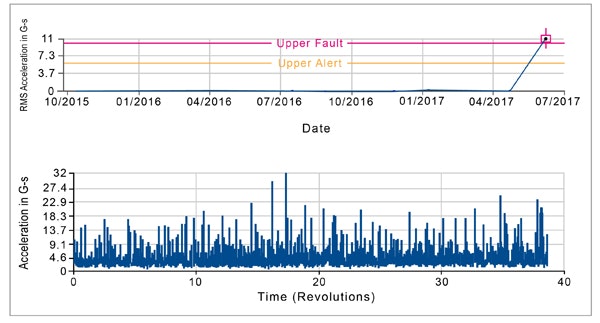

A facility can monitor lubrication conditions by monitoring stress waves, which are created by friction. Some industry tools can detect short-duration, high-frequency stress waves and produce graphs indicating their presence. Graphed data at right show a bearing in which the seal had been leaking and the lubricant washed out. In these underlubricated conditions, the software-generated graph shows the force of impacts. Notice that the impacts are random and that some are as large as 32G-s. Also notice in the top graph that the impacts began suddenly to reach the upper fault level. These are signature characteristics of underlubrication.
When improperly lubricated, a rolling element in a bearing might cause the inner or outer race to deflect and spring back, creating a stress wave. New technology can parse out the frequencies to see the stress wave, leading to the early detection and elimination of bearing anomalies.
