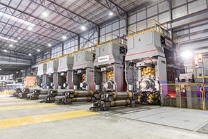

That was the case for Big River Steel, a steel production and scrap recycling company in Osceola, AR. Founded in 2014 and dubbing itself “a technology company that happens to make steel,” Big River focuses on employing advanced technologies to enable nimble production of cleaner, more-formable steels, including niche products such as electrical steels. (“True innovation is rebellious,” the company proclaims on its website.) In 2017, Big River Steel became the country’s first LEED-certified steel production facility.
For as technologically advanced and future-focused as the facility was, though, it still was dealing with the frustrating problems of unplanned downtime and time-pressed maintenance staff having to address urgent issues. So also in 2017, BRS started hammering out a plan with one of its suppliers for a performance-based contract—for bearings and seals.
Why bearings and seals (as well as related engineering and reliability services and tech)? “In our part of the mill, we have so many rolls with bearings that over the course of the years, some of our delays and downtime have been due to bearing failure,” says Tommie Kifer, BRS hot-mill manager.
Plus, “When the bearing stops, it’s the heart of the machine; everything stops,” says Steve Irvine, leader of the metals productivity team at SKF USA, which is providing “service as a solution (SaaS)” for bearings and seals for BRS. “Probably 99.5% of all bearings do not achieve their useful life,” because of problems related to lubrication, seals, maintenance errors, etc., Irvine says.
