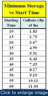

The usable storage should be large enough to maintain a minimum acceptable pressure during system events, such as the failure of the largest compressor. The length of time useable storage must carry the system depends on how long it takes the backup compressor(s) to start and fully load. The compressor starting time depends on whether it has an across-the-line or a wye-delta starter. With a wye-delta starter, the compressor’s starting time depends on the timer setting, which determines when it shifts from the start to the run contactor. In addition, after the compressor starts, it takes time for it to load. A lubricated rotary screw compressor might need 8 sec to pressurize its sump and a centrifugal compressor might require 15 sec or more for the control valves to fully load the compressor. When calculating the required usable storage, use 15 sec if the backup lubricated compressor starts across-the-line and 25 sec when it has a wye-delta starter. For oil-free rotary screw compressors, these starting times generally reduce to 10 and 15 sec, respectively. These times include a safety factor. On the other hand, it can take from 15 sec to 55 sec for centrifugal compressors to fully load from a hot start. So, unless you’ve measured this time, use 60 sec to calculate the required storage volume. Assuming that the backup compressor’s capacity is equal to the largest compressor’s capacity, then you can use the compressor’s starting time (Table 1) to determine the minimum usable storage required to carry the system through the failure of the largest compressor.

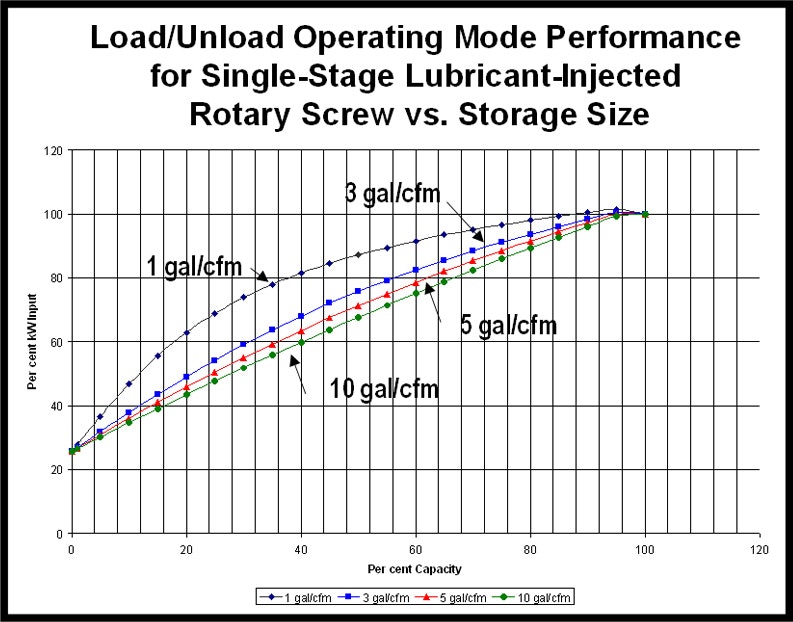

The efficiency of partly-loaded lubricated rotary screw compressors operating in the load/unload mode improves as the storage volume increases. Figure 1 shows that if a lubricated rotary screw trim compressor has a 40-sec blowdown time, then the usable storage required to prevent short cycling is enough to make the load/unload compressor a reasonably efficient trim compressor. However, compressors with extended blowdown times or limited blowdown intervals require additional usable storage to achieve the same part-load efficiency. Therefore, it’s best to base-load compressors having the greater restrictions and trim with those with fewer restrictions.

Figure 1. Load/unload operating mode performance as a function of storage capacity for a single-stage lubricant–injected rotary screw compressor.
