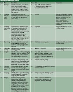

The personnel, whether company employees or hired contractors, must be highly skilled craftsmen. Reliability department engineers must work with the maintenance department to determine the skills required of the workforce, develop training for the craftsmen, and regularly test/qualify them. For example, the plant machinery specialist should develop, train, and test the craftsmen on the skills required to work in the plant. Figure 1 shows an example of a list of required machinery skills. Each asset should develop its own list based on the plant’s core tasks and skills required to complete those tasks. Each task should have a defined set of steps, conditions, and standards, and these should be taught to the personnel and repeated over a three-year cycle. This list should be a living document in that the list of tasks will change based on the plant’s evolution over time.
Figure 1. Each asset should have its own list based on the plant’s core tasks and skills required to complete those tasks.
