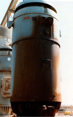

Figure 2. Evidence of lubricating oil leakage is visible on the exterior of this vertical motor. The cause of the leak should be investigated. Source: EASA

Visual inspection is another important mechanical activity. The motor should be inspected for missing, broken, or damaged parts; indication of lubricant leakage (see Figure 2), and for evidence of contaminants and blockages of the airflow paths. During PM or PdM services minor adjustments can be made, such as to belt tension or loose bolts; and dirt or contaminant accumulation removed from accessible locations. Thermal scanning using an infrared thermometer or camera can be used to check for over-temperature, or increasing temperature conditions. Similarly, ultrasonic testing can be used to detect bearing condition and adequacy of the lubricant fill.
