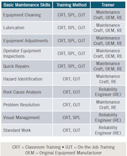

Training operators to perform basic maintenance
Training can be delivered through classroom and on-the-job training (OJT) and reinforced using single-point lessons (SPL). The SPL is a one-subject, one-sheet training method that reliability engineering personnel or a given department prepares and that focuses on a specific asset. Topics may include machine function, cleaning, lubrication, methods and criteria for inspection, quick repairs, and safety.
At every opportunity, explain the SPL to operators and encourage its use. Training of in-plant personnel to effectively utilize predictive maintenance technologies will require classroom training. However, the majority of skills necessary for front-line reliability are best taught through OJT and learning by doing. Single-point lessons provide a vehicle for learning about specific equipment defects or failures as well as their quick restoration to service. (See Table 1 for a training matrix for operator maintenance skills development.)
