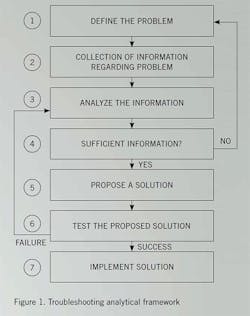

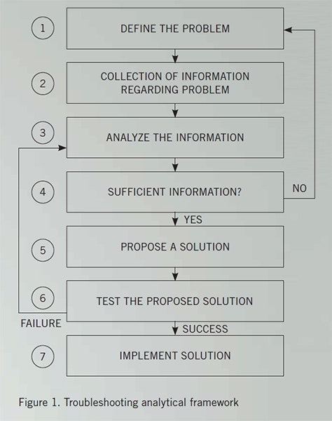

A general analytical model for troubleshooting is illustrated in Figure 1.
Step 1, defining the underlying problem to troubleshoot, can sometimes be difficult because processes are big, complicated, and interconnected with various material and energy balances. The troubleshooting process commonly starts with a process alarm, which alerts the operator that the process has exceeded a predefined process limit, such as a high process level, pressure, or temperature. The alarm’s cause may be unclear: For example, a low-level alarm in a vessel may sound, but the problem could be rooted in the feed to the tower and involve a problem in the tank farm.
Step 2 involves the collection of process data (current and the immediate previous history), which the operator will turn into useful information based on his or her overall situational awareness. The operator’s situational awareness is essentially the operator’s mental process worldview. Here is where the ICS can help by providing online alarm troubleshooting assistance, designed to diagnose the problem based on commonly known alarm causes and suggest remedial procedures and guidance. The ICS will have a number of capabilities that should be used to their fullest extent to help the operator troubleshoot process problems. The ICS must provide factual, reliable, and trustworthy data and present the process data in consistent, concise, and useful manner. It is important to determine that there really is a problem and what it is.
Step 3 involves analyzing the data to find a root cause and to determine whether there is sufficient information to propose a solution to the process problem. Case-based reasoning initially tends to dominate the analysis. Case-based reasoning is based on the whether the operator has seen the problem or something similar before. This typically leads to the operator to try the previously employed solutions. The downside is that the operator may not think the problem through, and the proposed solution may waste resources or makes the problem worse. This is not to say that past experience is not valuable, but some cognitive thought processes should be applied before jumping in, or the operator may jump from the frying pan into the fire.
Logical analysis typically starts with the big picture and works to narrow perspective into smaller pieces to be analyzed to identify what is causing the problem. If the problem’s big picture is easily divisible, divide the problem in half and determine which half still has the problem, and then divide again until the problem’s cause is identified and a solution is proposed.
One key question is whether something has changed in a process or in a piece of equipment’s operation. The change can be sourced to a human (e.g., a valve is operated in error, controls have been changed; the production rate has changed, etc.) Alternatively, it may be sourced to a nonhuman factor. Look for potential changes such as feed rate or composition changes from outside the plant, cooling medium changes, steam supply variation, tower flooding, exchanger clogging, ambient changes (e.g., changes in ambient temperature, rain, lightning, etc.), or anything that doesn’t look normal.
Developing a time line from when the process went off normal can be valuable in identifying when equipment failed or when a change may have occurred.
Step 4 is deciding whether sufficient information exists to propose a solution to the identified problem. If the answer is “no,” return to the data-gathering of Step 2.
Step 5 is proposing a solution to the process problem.
Step 6 is testing the solution. If the test is successful, the problem is solved. If not, we go back to Step 3 to see where the analysis went wrong. In the event that more than one seemingly viable solution is proposed, the operator must decide which to try first. Typically, potential solutions are tried in order of their estimated likelihood of fixing the problem. However, other factors may dictate the order in which solutions are tried: Safety, ease of application, cost, resource demands, and personal choice all can tip the scales in favor of one potential solution being tried before another.
