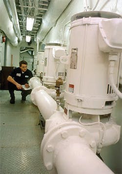

Occasionally an end user wants to take a motor designed for horizontal mounting and use it in a vertical position. (Figure 1 illustrates a horizontal motor in a vertical shaft down position.) This article addresses some of the key mechanical factors that should be considered when applying a horizontal ball-bearing motor in a vertical mounting position.

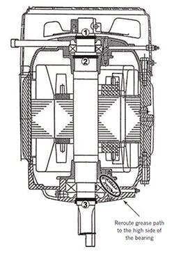

The next key factor is bearing lubrication paths. Figure 2 illustrates an across the face lubrication path for a motor in the horizontal position (2a), and in the vertical position (2b).
If the motor is oriented vertically with the shaft end up, the grease entering the lubricant chamber of the drive end bearing in Figure 2 will tend to go through the bearing and leak into the interior of the motor. If that occurs, only a small amount of grease will reach the grease relief that should be opened during the relubrication process. The scenario that could occur is that the person lubricating the bearing will add more grease until lubricant is observed exiting the relief port. The consequence is overlubrication of the bearing and a probable reduction in bearing life. To prevent leakage a lip seal can be added below the bearing at position #2 in Figure 2b.
If the motor is oriented vertically with the shaft end down, the grease entering the lubricant chamber of the drive end bearing in Figure 2 will tend to go through the chamber and not reach the bearing. This scenario is further assured as the person relubricating the bearing probably will cease adding lubricant when grease is observed exiting the relief port. Modifying the housing to convert from “across the face” to “through the bearing” as illustrated in Figure 3 will provide a more-positive lubrication path for the drive end bearing. The modification is done by drilling a hole at about a 45-degree angle as shown in the circled section of Figure 3. This allows the lubricant to enter the chamber on the inboard side of the bearing, thus providing a lubricant route through the bearing. Note: The grease should enter above the bearing and discharge below the bearing.
The lubrication path of the opposite drive end bearing also needs to be addressed. If the motor orientation is vertical shaft end up, the opposite drive end bearing is the lower bearing, and its housing can be modified the same as was done for the drive end bearing with the shaft down orientation. Similarly, if the motor orientation is vertical shaft end down, the opposite drive end bearing is the upper bearing and its housing can be modified the same as was done for the drive end bearing with the shaft up orientation.

If the motor is vertical shaft up or has an upper shaft extension such as for an external cooling fan, a lip seal should be installed at location #1 as shown in Figure 4. That will help prevent external contaminants from entering the upper bearing lubrication chamber. Note: For optimum seal life size the seal for a shaft diameter should be 0.020” (0.5 mm) larger than the actual shaft diameter.
If there is a shaft extension at the lower end of the motor, adding a lip seal as shown at location #3 in Figure 4 will aid in retaining lubricant in the lower bearing and its lubricant chamber. Similarly, adding a lip seal as shown at location #2 below the upper bearing will aid in retaining lubricant in the upper bearing and its lubricant chamber.
A drip cover may be added to a drip-proof motor that is mounted shaft down to provide additional protection against entry of liquids such as water. Figure 1 illustrates a drip-proof horizontal motor mounted vertically shaft down and with a drip cover.
