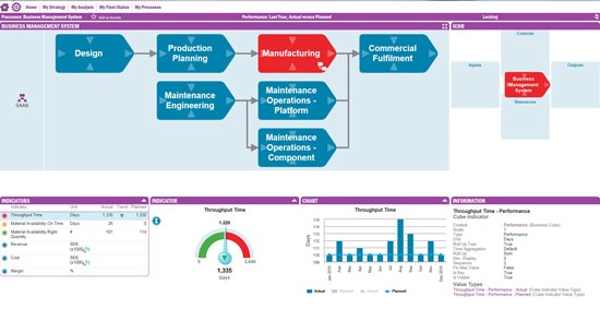

Some operational intelligence tools deliver real-time visibility into current and forecasted operational issues and even identify likely solutions. Source: IFS
