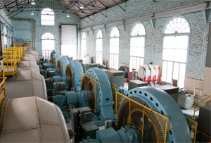

Power generation, transmission, and distribution operations are prime candidates for mobile technology. NorthWestern Energy inherited a mobile solution during a 2014 acquisition of 11 hydroelectric facilities and associated assets in Montana with a net aggregate generation capacity of 633 MW.
“Our hydro plant operators use the mobile solution for daily, weekly, and monthly safety, security, and operational inspections,” says Amber Osterman, business analyst at NorthWestern Energy’s Business Technology Department. “Over a month’s time period, we gather about 15,500+ reading documents. That is about 500+ readings per day for 11 plants.”
