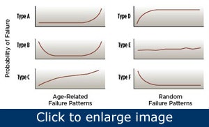

Before the 1960s, it was commonly believed that failure probability increases over time for most assets and components, this following a relatively stable period of random failures. This failure pattern is depicted in Figure 1 as “Type A,” showing likelihood of failure versus time. Extensive studies by the airline and military industries found, surprisingly, that age-related failures accounted for about 20% of all failures. This included types A, B and C failure patterns. Instead, the more prominent failure patterns for assets and components were found to be random in nature and accounted for roughly 80% of failures. These include types D, E and F. All failure pattern types can be summarized as follows:
Figure 1. These plots of probability-versus-time represent common failure mode types.
Type A: As an asset or component’s age approaches its expected life, and after an initial period of random failure, there’s a rapid increase in the likelihood of failure.
Type B: Commonly known as the “bathtub curve,” this failure pattern is particularly relevant to electronic equipment. There’s an initial period during which there’s a higher likelihood of failure, but this gradually decreases and the curve then follows the Type A pattern until the asset or component’s end of life.
Type C: This pattern shows a steady increase in failure likelihood as the asset or component ages. This pattern might be caused by constant fatiguing.
Type D: Other than an initial break-in period during which the probability of failure is relatively low, this failure pattern shows an equal likelihood of failure at any point in the asset or component’s life.
Type E: The Type E failure pattern has an equal likelihood of failure, regardless of the age of the asset or component.
Type F: As with the initial period of the bathtub curve, the Type F failure pattern starts with a relatively high likelihood of failure. After the initial period, this type then mimics the two other random patterns. Type F failure pattern is often tagged as infant mortality.
