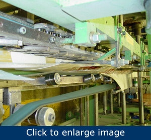

At its Olmsted Falls, Ohio, plant, Evergreen produces milk cartons from rolls of paperboard supplied by one of its paper mills. The plant uses eight sealers and converting machines to fold, print, die cut and seal the cardboard cartons (Figure 1). The high-speed converting operation produces cartons ranging in volume from four ounces to one-half gallon, with an average output capacity of approximately 400,000 cartons per hour.
Figure 1. An integrated control platform provides benefits for a plant that manufactures milk cartons and other converted paper products.
After a converting machine prints the words and images on the paperboard, the same machine scores the paperboard along what will be the edges of the milk carton, where the box will fold later. A die lowers and stamps out a flat, scored and printed piece called a blank.
The blanks are loaded into a sealer, which takes the blank and folds it laterally into an overlapping side seam. The seam is heated and squeezed. The sealed and folded blanks are then loaded into corrugated cartons and shipped to the dairy. The dairy uses specialized machinery to transform the blanks into open containers, where they’re filled and top-sealed.
