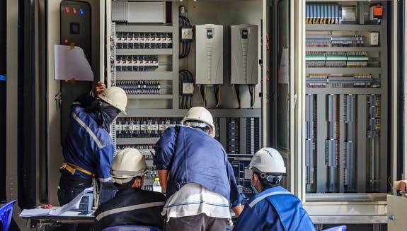

PLCs (programmable logic controllers) are found everywhere in industry today. Proper PLC system design can provide many years of service for a machine or process and greatly improve efficiency and profitability for the owner.
Why do we use a PLC? PLCs can be “relay replacers,” providing logic, timing, and counting capabilities that would be difficult to do with discrete components (see Figure 1). PLCs can perform math functions, making calculations based on external signals and/or HMI (human-machine interface) input. A good example of PLC use is with VFDs (variable frequency drives). PLCs can now be networked to many VFDs via Ethernet/IP or other fieldbus type communications protocols. By using the communications protocol, a great deal of wiring can be eliminated.
Before we apply a PLC to a machine or process, let’s look at some design and maintenance practices that are critical to a successful implementation.

Always keep electrical panels free of dust, dirt, and other debris. Make sure that wiring is kept neat and wire duct covers are kept in place. Periodically, all screw terminals should be inspected and tightened. Do not overtighten the terminals; snug is good, but overtightening can make things worse. If in doubt, follow the manufacturer’s recommendation for a torque setting.
Make sure the panel is labeled with the networking IP addresses, fuse ratings, the PLC program file’s name, and anything that makes it easy to service the machine.
