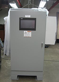

Figure 1. Package Boiler#1 CCS Cabinet assembly with panel mounted HMI
Project details
The demolition of existing hardware and re-wiring was completed in Week 1; startup, checkout, testing, and commissioning were completed in the Week 2. Total duration of the outage for each package boiler was less than 10 days. The controls for each package boiler included new Burner Management System (BMS) and Combustion Control System (CCS) cabinets (see Figures 1 and 2).

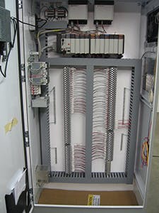

Figure 2. Package Boiler#1 CCS Cabinet Internal Wiring
For BMS & CCS control cabinets, a single non-redundant control processor was used with required I/O modules. Both cabinets were pre-wired and tested in the shop prior to shipping to the site. The CCS cabinet was also fitted with an HMI for local control.
