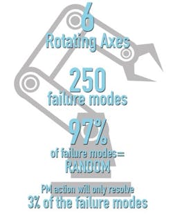

Figure 1. The preventive maintenance you’ve been trying to complete will at best only resolve 3% of the failure modes associated with your robots.

We recently worked with a group of robot experts to perform a reliability-centered maintenance (RCM) analysis of a manufacturing robot that had six rotating axes. In analyzing the equipment and controls, the team identified more than 250 failure modes, 97% of which were random-based (Figure 1). While an RCM purist might find some comfort in these numbers, the average maintenance and operations manager should pause and take note: The preventive maintenance you’ve been trying to complete will at best only resolve 3% of the failure modes associated with your robots.

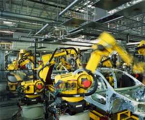

Robot joints move slowly and rarely rotate a full 360°, making it impossible to assign discrete fault frequency content. Combine that with the safety issues of being anywhere near one as it operates, and it makes it difficult, if not impossible, to apply traditional vibration analysis techniques. The robot’s bearings and gears are encased in housings that sink heat away; combine that again with the fact that most robotic joints rotate slowly, and thermographic imaging is no longer a viable option. While contact ultrasound could be an option, the twisting and turning of the robot’s joints makes it difficult to apply long enough to get a useful sound signature that would indicate potential failures. Considering all of these issues, one might attempt to install a condition-monitoring technology permanently with the hope that a continuous signal might detect enough vibration, noise, or heat to indicate potential failures, but the twisting and turning of the robot’s various axes create a whole new set of challenges (Figure 3).
Figure 3. A continuous signal from a permanently installed condition-monitoring technology might detect enough vibration, noise, or heat to indicate potential failures, but the twisting and turning of the robot’s various axes create a whole new set of challenges.

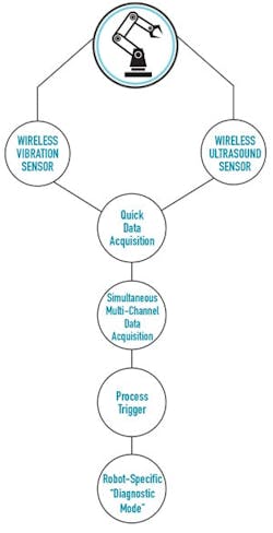

Figure 4. Utilizing high-frequency domain data available with this monitoring solution allows for the earliest possible notification of issues developing, which will allow ample time for proactive initiatives.

We permanently installed sensors in a way that allowed monitoring of the robot on a near continuous basis without interfering with the robot’s performance. The equipment has to work with a wireless transmitter to enable sending information from up to seven sensors on as many robots as the customer wants to analyze (Figure 4).
The result is a system that uses data from vibration monitoring and contact ultrasound and allows the setup of robot/joint-specific analysis parameters and alarm bands based on readings and emissions. Using a wireless vibration monitoring system enables quick data acquisition capabilities. Combine this simultaneous multichannel data acquisition with process triggers and robot-specific, diagnostic-mode operational programming, and you get consistent repeatable data for trending and analysis. Utilizing high-frequency domain data available with this monitoring solution allows for the earliest possible notification of issues developing, which will allow ample time for proactive initiatives. Data from early testing of the system on live robots indicates an on-line solution to detect nearly all of the failure modes associated with the rotating components of a robot.
