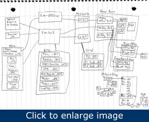

A drawing with lines and boxes isn’t a network/security design. (Rockwell Automation)
