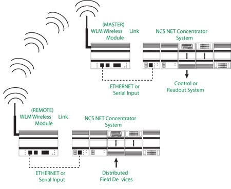

This involves mounting a transmitter and an antenna at remote sites and an antenna and receiver at the controller site in a point-to-point configuration (Figure 1). Then, fire it up and see if it works. The radio’s onboard diagnostics quantify the signal strength on each hopping frequency the radios use to transmit data. This also helps to determine if any portion of the spectrum is subject to interference from co-located radio systems or cell towers. If so, the final wireless system can be programmed to ignore the “noisy” portions of the spectrum.
Figure 1: A simple point-to-point demo system gathers data at a remote site and transmits it to a receiving system in the control room.
