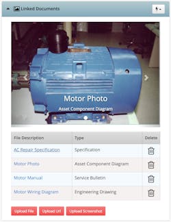

  • Make it a standard for maintenance personnel to take pictures of the equipment/device nameplate as part of their work and upload them to the CMMS.
  • If outside contractors for are used for PMs, require detailed PM reports with photos of nameplates and equipment arrangements and upload them to the CMMS.

  • Take photos of the nameplate and component.
