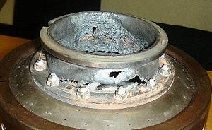

Higher hydrocarbon species
Associated gas from oil production is a common gas turbine fuel. Methane is usually the major constituent but associated gases can be rich, containing considerable quantities of heavier hydrocarbons — ethane, propane, butane, pentane, and potentially even longer hydrocarbon chains. In some instances, heavier hydrocarbons may be considered a waste product from gas processing and can be either used on their own — ethane, propane, LPG — as a gaseous fuel or deliberately blended into a methane-rich gas and used as a gas-turbine fuel as a means of disposal. Higher hydrocarbons can also be used in liquid form; there are numerous gas turbines operating on LPG and naphtha fuels.
The presence of higher hydrocarbon species in a gas fuel can lead to auto-ignition problems within the combustion system. The longer hydrocarbon chains can ignite spontaneously at temperatures below the compressor discharge temperature, so it is important to minimize the residence time of the fuel gas in the combustor so that controlled combustion occurs in the correct place.
Figure 1. If the gas fuel temperature isn’t maintained, condensate can impinge on combustor surfaces leading to localized burning and component failure, which can occur very rapidly and result in engine shutdown.
Higher hydrocarbon species impact the hydrocarbon dew point of the gas fuel, and hence high supply temperatures are required to ensure these remain in the gaseous phase. If the gas fuel temperature is not maintained, then liquid dropout —  condensate — will result and can cause problems in the fuel system or, more seriously, impinge on combustor surfaces leading to localized burning and component failure (Figure 1).
