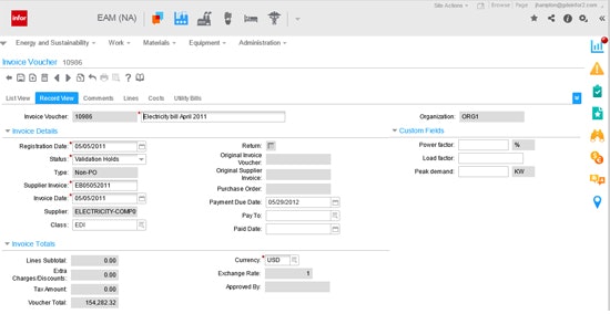

Bill Miller, the enterprise asset management (EAM) asset sustainability maintenance administrator for the WRA, had initially proposed the idea of implementing an asset sustainability application to help the facility efficiently maintain its equipment, locations, and assets. Due to its uniqueness and industry-specific capabilities, decision makers selected Infor EAM Energy Performance Management for the project. The WRA’s goals for the initiative included integrating data between the new application and its existing supervisory control and data acquisition (SCADA) and Hach Wims water management applications. Additional objectives were to establish and configure energy and condition monitoring capabilities and to analyze asset energy usage trends to detect excessive energy use and help reduce costs. By identifying potential savings opportunities using sustainability technology, the facility would be better-equipped to meet all maintenance requirements within its current budget.
Implementation of the application began in July 2010 and was completed in January 2011. Project leaders first established maintenance best practices and then set up and configured Infor EAM Energy Performance Management around the best practice model before integrating the solution with the existing systems. These steps helped to minimize implementation challenges and allowed the WRA to become the first facility in North America in the water and wastewater field to achieve PAS 55 certification, which is a designation recognizing the optimal management of physical assets.
Only six months after deployment, the WRA was able to decrease energy usage by 100,000 kWh using its new asset sustainability technology. Noting that the facility accounts for 50% of the local city government’s power costs, this resulted in significant overall savings for the City of Des Moines.
“Prior to this project, we were not aware that certain process air blowers in our facility were running more often and less efficiently than others,” says Miller. “Now we have the real-time data to monitor each blower individually to ensure all are running at the optimum level, saving significant energy.”
By enabling in-depth asset analysis and data capture, the WRA has developed more efficient asset maintenance plans to help prolong asset lifespans and ensure more timely equipment upkeep. With consolidated, real-time information access, automated alerts, and advanced reporting capabilities, the facility can now compile custom physical condition lifecycle reports, which combine data on work order histories, energy consumption, facility conditions, and inspections, delivering a complete picture of the WRA’s operations. This provides engineering and finance users with critical information necessary to schedule asset maintenance and replacements that will optimize efficiency and eliminate avoidable costs.
Since the initial implementation, the facility has integrated several major systems with the solution and is currently tracking 50% of its total monthly energy consumption down to the individual asset level. To date, the WRA has realized annual savings of $200,000 and increased overall energy efficiency and maintenance productivity by 25%. The facility also improved productive (wrench) time for maintenance technicians to repair or replace assets from 20% to 75%, compared to an industry average of 30-50%.
