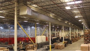

A mechanical contractor's industrial ventilation design has provided significant energy savings for Mi-T-M, an industrial power equipment manufacturer in Peosta, Iowa. The system provides indoor air quality (IAQ) for quality assurance painting, welding, and laser-cutting production line processes, as well as employee air comfort.
Mi-T-M retrofitted a 420,000-sq-ft former warehouse into an HVAC-controlled industrial production facilities. However, it wouldn't have been possible without a design team consisting of Mi-T-M's former director of operations, Patrick Siegert; Daniel Fens, design/build engineer at project mechanical contractor, All Seasons Heating & Cooling in Dubuque, Iowa; factory engineers at fabric HVAC duct manufacturer, DuctSox; and mechanical equipment manufacturer, Titan Air Inc.
A rooftop ventilation system and exhaust fans with spiral metal duct would have been a conventional solution, but All Seasons, a 30-year-old industrial/commercial/residential mechanical contractor that specializes in design/build geothermal, industrial, and custom home HVAC, turned to some out-of-the-ductwork thinking and took advantage of recent HVAC technology advancements.
The design team used the first industrial application of DuctSox's new Skelecore FTS fabric ductwork in-duct cylindrical tensioning system and combined it with high-efficiency TA Series make-up air units from Titan and industrial filtration systems by Donaldson.
The uniqueness of the system is derived from All Seasons’ division of the concrete tilt-up facility into six zones, each having its own make-up air system that's activated for partial or comprehensive ventilation or heating only when the respective production lines are operating. The design's efficiency is facilitated by variable frequency drives (VFDs), modulating natural gas valves, and a variety of building pressurization sensors and controls overseen by the Metasys building automation system manufactured by Johnson Controls.

Skelecore FTS, which was originally designed to appease architects and building owners that didn't like all fabric duct's inherent deflated appearance or wrinkling during idle or throttled air handler periods, makes textile duct and the design team's variable speed airflow possible. The rule of thumb on VFD use with conventional textile duct is static pressure loss will occur if the fabric is deflated 30% or more during operation. Therefore, the in-duct tensioning system's ability to maintain a 100% inflation, regardless of airflow, enables any airflow dictated by the BAS and eliminates the need of metal ductwork.
Consequently, using fabric duct also reduced ductwork installation costs by 75% versus metal duct, explains Jerry Tigges, All Seasons' project supervisor. Hanging six 180-ft runs, ranging from 32- to 60-in. diameters, would have taken four times longer with metal. Instead, Tigges and just one other crew member hung one duct run per day, which weighed a total of 400 lb versus 1,800 lb of metal.
