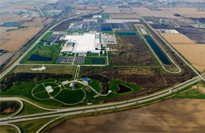

Subaru of Indiana Automotive (SIA) is located in Lafayette, Indiana, the seat of Tippecanoe County, located about an hour from Indianapolis and just across the Wabash River from West Lafayette, home of Purdue University. Far from being a one-industry rust-belt community, Lafayette is a hub of education, art, and interesting architecture. Lafayette also displays the kind of environmental awareness you'd expect of a cosmopolitan college city, an awareness that's shared and supported by SIA.
A subsidiary of Fuji Heavy Industries, SIA is the home of North American Subaru production. The Subaru Legacy, Outback, and Tribeca are built here, along with the Toyota Camry, which was added in 2007. SIA employs more than 3,600 associates, and the plant's ability to attract Toyota as an assembly customer is a testament to its skill and quality ethic. But the remarkable facts about the plant don’t stop there.
In May 2004, SIA became the first auto assembly plant in America to achieve zero landfill status. SIA’s entire 832-acre site with six ponds has been designated a backyard wildlife habitat by the National Wildlife Federation.
