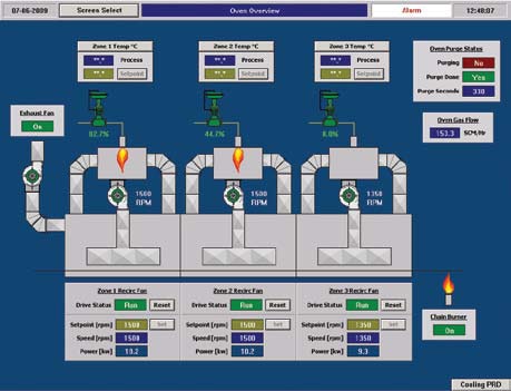

Oven overview screen
A PowerFlex 700 AC drive controlled the 125-hp cooling fan, and three PowerFlex 70 AC drives were installed on the 40-hp oven recirculation fans. PowerFlex drives have a broad spectrum of attributes that met Owens Corning’s needs for space, flexibility and reliability, including monitoring, safety, configuration, installation and space-saving features. The advanced motor control performance helps gather process information at the drive level and automatically disperse it to any part of the plant via remote I/O.
The RSLogix software also helps reduce programming time and helps provide easy startup, diagnostics and troubleshooting. Owens Corning operators and maintenance staff use the drive features to monitor the motor kilowatts, drive status, speed, fault code and output torque.
“I can easily map data out of the PowerFlex drive,” says Peel, “where I’ve found other drives are more cumbersome.”
Diagnostic information also can contribute to plant safety. If a broken belt stops an oven fan, the loss of air circulation could start a fire. Using the drive’s torque feedback, the PLC monitors the motor load on the fans, detects a belt break as soon as it happens and alerts the operators. The flame safety system pressure switches detect the loss of air flow and shut down the burners.

Since installation of the three PowerFlex 70 drives on the oven zones, the 40-hp fans reduced speed from 1,800 rpm at full speed to 1,500 rpm on two of the fans, and 1,350 rpm on the third, reducing kilowatt usage from 56 kW to 21 kW.
An unexpected advantage of reducing the fan speed with drives is a 7.5 cubic meter per hour reduction in the amount of natural gas used in the ovens.
With less air circulating, there’s less heat loss, resulting in less gas to maintain the temperature, for $1,000 to $1,400 gas savings per month and annual electricity savings of $15,000. The drives also contribute to safety at the ovens, through diagnostic capabilities such as drive torque feedback.
