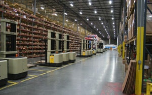

Since its inception in 1977, West Marine of Watsonville, Calif., has become one of America’s top retail and wholesale recreational boating products suppliers. When the metal halide lamps in its 476,000-sq.-ft. South Carolina distribution center reached the end of their useful life, the company sought a more energy-efficient lighting system.
Pat Murphy, vice president of logistics for West Marine, compared several options and determined that a system from Westinghouse Lighting Solutions best met West Marine's specifications. The Westinghouse system uses a reflective aluminum technology called Miro, which reflects nearly all the light the fixture generates.
“When we looked at the application, the Miro reflectors made the most sense for us,” Murphy says. West Marine also installed motion sensors to reduce power consumption in areas of limited work activity. According to Murphy, the system “reduced the monthly bill by about half. It's been consistent and worth a lot.”

The sum of these improvements allowed West Marine to realize a payback on its lighting investment in about one year. That translates to an annual energy savings of more than $150,000. “It’s a very nice contribution at the bottom line of the company,” Murphy says. “Everybody loves it.”
