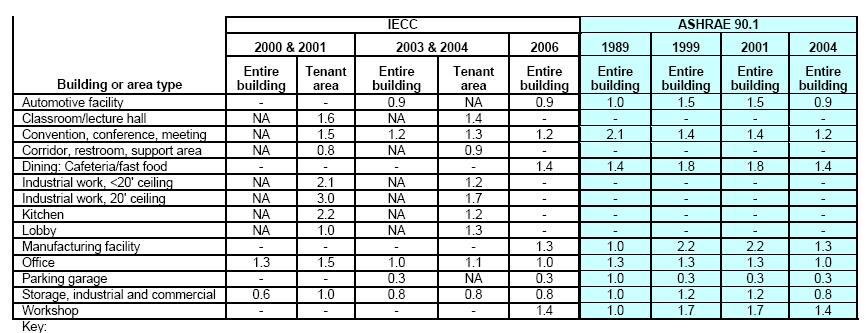

Both the 2004 ASHRAE 90.1 and 2006 International Energy Conservation Code (IECC) publications reduced the allowable lighting power density for buildings by an average of 26 percent (Table 2).
Table 2 - Click to enlarge
