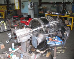

Figure 1. This open view of a turbine shows the close fit between the wheels and the housing on a smaller Elliot E-Line steam turbine. If the rotational speed of the turbine exceeds the safe operating limits of the unit, the main shaft and impeller wheels can be pulled apart by centrifugal force.
Most industrial jobs bring with them a few potential mishaps that can keep a conscientious technical person awake at night. For operations and technical support people who look after large steam or gas turbines, overspeed failures can provide frequent nightmares.
An overspeed failure on a big steam or gas turbine is one of the most frightening industrial accidents. A huge amount of thermal, chemical, and mechanical energy courses through a big turbine when it runs. If the rotational speed of the turbine exceeds the safe operating limits of the unit, the main shaft and impeller wheels can be pulled apart by centrifugal force. In the worst case, the disintegrating parts can break through the turbine housing, flinging hot, fast-moving shards of metal in all directions. The results of such a failure are always very costly and can be fatal to personnel in the area (Figure 1).
