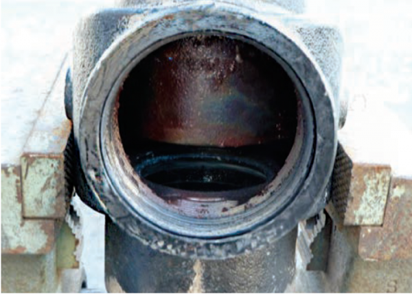

Figure 4. MPCV ready for disassembly and cleaning.

Minimum pressure check valve
Typically, once per quarter you should disassemble the minimum pressure check valve (MPCV) and clean it, and once a year you should rebuild this component (see Figure 4). If you don’t maintain this item, you will run into all sorts of reliability issues, such as the compressor not starting or unloading properly.
