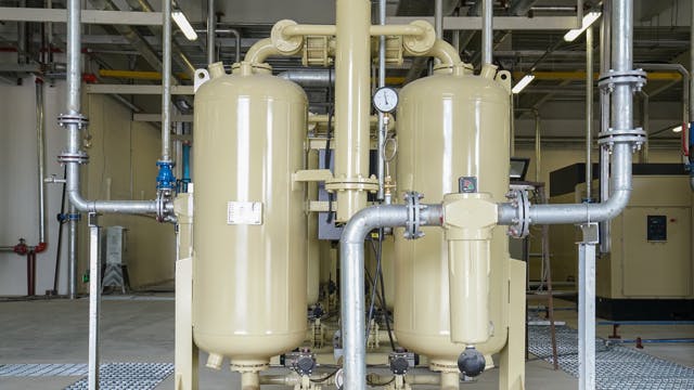

A desiccant dryer uses desiccant beads to adsorb the moisture, and can provide a dewpoint between -40 °F and -100 °F. However, as the surface area of the desiccant beads surface is covered by moisture, they need to be regenerated – hence the need for two towers in a standard desiccant dryer. One bed is the working bed, while the other is regenerating. The regenerating side uses energy to remove that moisture, which can be accomplished using the compressed air itself, heat, and/or an electrical blower, to name a few. A typical heatless regenerative desiccant dryer will consume 15% of the dryer capacity (cubic feet per minute, or CFM) to regenerate the desiccant bed, which can be extremely costly! Nonetheless, there are systems that require this level of dry air, such as certain food processing and pharmaceutical industries, in which the high costs of these dryers are just the cost of doing business.
Think of the desiccant beads like a group of round sponges. As moisture flows across the material, the sponge will absorb that moisture. Over time, the sponge becomes fully saturated and unable to absorb any more moisture – which is why the beads must be dried internally through the regeneration process to maintain functionality. The difference in a desiccant bead is that it adsorbs instead of absorbs, making the moisture stick to the outside surface area of the bead.
