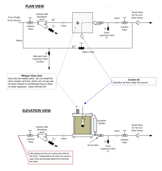

Some low-cost units can be sensitive to contamination and may fail easily due to obstruction. This needs to be considered during the purchase process, with purchase directors weighing both application conditions and the degree of maintenance required. One common issue to be aware of is the use of strainers installed ahead of a drain valve. In theory, the strainer will collect larger particulate and protect the drain from failing because of obstruction, but the strainers often are neglected and become clogged. It’s important that if a strainer is installed, a manual valve and piping arrangement also be installed ahead of the drain to facilitate easy isolation for servicing and testing.
Proper piping to move condensate
Condensate piping must be configured to facilitate easy removal of every drain for service or inspection. A bypass should be installed on the discharge side of every drain to support testing the drain operation. This should include a tethered hose for systems to periodically test the condensate discharge rate using a scaled collection device over a fixed period of time.
