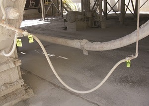

  • to send the message to all that eliminating waste is a priority, but this only works if the leaks get fixed (Figure 5).
Figure 5. Use a physical tag to clearly label each leak in your plant.
