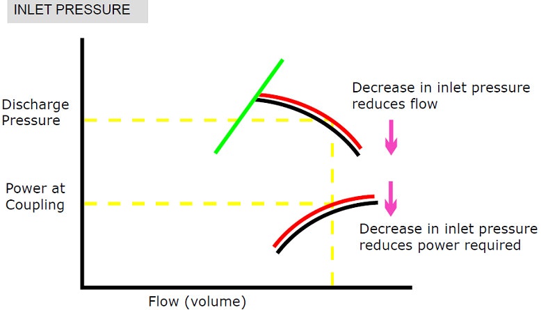

Pressure and flow rate comparison
At a constant rotational speed, the pressure/flow curve for a dynamic compressor (turbocompressor) differs significantly from an equivalent curve for a positive displacement compressor. Turbocompressors operate with a variable flow rate and variable pressure characteristics, while displacement compressors operate with a constant flow rate and variable pressure.Variables affecting positive displacement and dynamic compression
Positive displacement and dynamic compression are affected by different variables. The following calculations show the influence of factors such as inlet pressure, inlet air temperature, volume flow, mass flow, and pressure ratio on power consumption and performance.
Positive Displacement: Inlet pressure, volume flow, and pressure ratio are the only variables that influence the power consumption in positive displacement compressors. Inlet air temperature and mass flow (density) have no effect on power.

Dynamic Compression: Inlet temperature and mass flow (density) have a direct effect on the power of dynamic compressors.
H: Isentropic head
R: Real gas constant
T1: Inlet temperature
K: Spec heat ratio cp/cv
P2/P1: Pressure ratio
The following diagrams illustrate the effect of inlet temperature, molecular weight, and cooling water temperature on the performance of a dynamic compressor.
As inlet air temperature decreases, flow and power increases.
As molecular weight increases, flow and power increases.
As the cooling water temperature decreases, flow and the power requirement increases.
