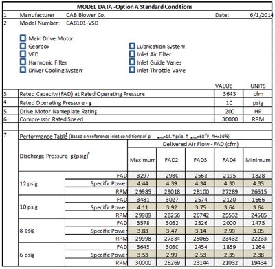

A standardized data sheet is developed for fixed speed and variable speed packages. The manufacturer provides the flow and specific power to achieve the stated flow at pressure increments of 2 psig.

BL5389 data sheet
A sample data sheet for a standard packaged high-speed-turbo blower package reported delivered volume flow of the machine and the corresponding specific power for the stated operating speed (Figure 1).
Figure 1. A sample data sheet shows delivered volume flow of the machine and the corresponding specific power for the stated operating speed. CLICK TO ENLARGE THE IMAGE

Class A — Data sheet performance verification: The objective of testing is to confirm that the stated performance of a manufacturer’s standard package meets the published performance on each of the tabulated points.
The as-built package would be tested for volume flow (FAD) and power at the prevailing ambient conditions. For variable speed machines, measurements are taken at maximum, minimum, and three equally spaced speed points along the lines of constant pressure. The speed is noted for each of the operating points. For fixed speed packages, only the information for the maximum (nominal driven) speed is recorded.
Flow and power are measured and correlated back to FAD conditions. The package is then rated as pass/fail on each of the points. For a failure of any point, the data sheet verification is a fail.
