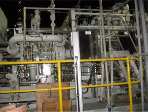

An integrally geared compressor for a critical service in a plant could not achieve 99% availability defined by the risk assessment team for the commercial viability of the plant (Figure 2). The team asked what should be done to this machine to achieve availability greater than 99%. Investigations showed a backup, or standby, compressor for this machine is necessary, if 99% availability should be achieved. There are many options — for example, an oil-flooded screw compressor, another similar integrally geared compressor, or a conventional-type centrifugal compressor. After a study of all options, the best recommendation was to buy a backup, or standby, compressor that uses the similar compressor model with an improved packaging concept. The new compressor will be a standby, or backup, machine. This should be similar to the existing compressor model to reduce spare parts and operational and maintenance complexity. This selection can also provide a reasonable cost because an integrally geared compressor is cheaper than a comparable conventional-type centrifugal compressor.
Figure 2. This integrally geared compressor is a well-designed package that can achieve a high availability.
The following improvements were recommended for the compressor package:
  1. Two identical E-motor driven lubrication oil pumps should be used instead of a single pump in the existing compressor package (electric power supplied from different electrical sources).
  2. The existing compressor used an inlet throttle valve (ITV) for the capacity control. A better capacity control method, inlet guide vane (IGV) system, should be used.
  3. Combined anti-surge/control system is recommended. The proposed control option is a combined control system, rather than two independent control loops, used in the existing package. This control solution should use the anti-surge valve (bypass) only for the anti-surge application. This can eliminate the root cause of some control issues. Trip and alarm parameters and limits should also be improved for a better operation.
  4. An optimum and improved system of condition monitoring for the package, including compressor and electric motor, should be considered. Online vibration monitoring should be provided for the electric motor.
This new compressor skid can also be used as an example to improve the existing skid.
Another proposal was to purchase a spare bare compressor (compressor frame) and keep it in the warehouse for a quick compressor replacement in case of any issue. This proposal was rejected.
More than 65% of all compressor package issues and problems are related to auxiliaries and accessories, rather than the compressor frame itself.
A spare machine, not a spare part, should always be installed and operational. It is a mistake to buy a machine, such as a pump or a bare compressor, and keep it in the warehouse. There were cases in which a spare machine in the warehouse couldn’t be matched inside its package. In most cases, machines were damaged or destroyed in the warehouse. Machines are complex and delicate systems and require constant attention and monitoring to make sure they will work when needed.
