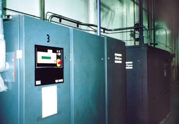

New four-stage compressors have helped Plasticpak Packaging Inc. reduce its energy costs by 40 percent.
For Plastipak, some of the proof is already firmly in hand. The compressors generate a 49 to 50 Kw savings every hour, 24 hours a day. As a result, the company has reduced its energy costs by approximately 40 percent. "In energy savings, that's $80,000 to $100,000 annually per machine," says Shane London, conversion manager, facility and engineering manager, Plastipak. "I knew the four-stage would offer more energy savings, I just didn't realize how much." To date, annual wear on the machines is at 25 percent of what the company expected, while maintenance costs are at 20 percent of expectations. Other benefits include $90,000 in rebates from Massachusetts Electric. The utility also purchased Plastipak's existing 3-stage compressors.
