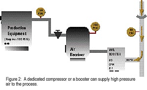

Do you run high system pressure to serve only a few users?
When we perform a compressed air audit, the first thing we check is whether high-pressure air is actually required. If it is, the next issue is how we can modify the process to reduce air pressure — changing to a larger diameter air receiver, for example. If not, there are alternate ways to handle this situation.
The first job is to measure the amount of air in cfm, the required pressure in psig, the duty cycle and so forth. With this data, we can calculate the most effective and efficient answer. Perhaps this involves using a dedicated compressor to supply air or a booster to supply high pressure air (see Figure 2).
