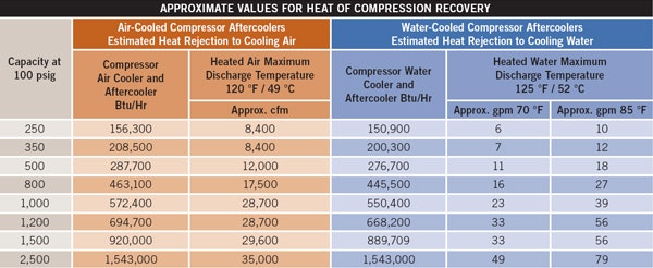

How much heat (Btu/hr) is available?: Figure 2 shows some values for lubricant-cooled rotary screw compressors. Oil-free and other lubricated units usually use water-cooled in the larger sizes, and the retained heat of compression in the cooling water or air media would be similar.
Figure 2. Air-cooled units usually try to collect all the air in one airstream and then duct the heated air as required to a desired location. Heat recovery energy saving and projects are often much easier to implement with the heat well trapped in the controlled water flow.
