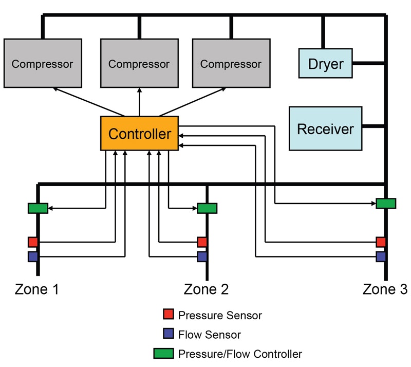

With the ability to monitor and respond to multiple air pressure and flow sensors comes the ability to also manage different pressure levels throughout a plant. A factory’s compressors and compressed air delivery systems can be organized into networks that may be optimized to use energy most efficiently and to provide backup air sources when needed. The control system can take inputs from certain zones of the plant, certain pieces of equipment, and production lines or machine centers. The system can provide just the right amount of air at just the right time to meet those needs. Zones supporting inactive production lines can be closed off. Figure 2 provides an example of the type of pneumatic network that can be constructed.
Figure 2. The controller can manage a network that supplies compressed air to different parts of the factory.
Active control capability can also allow for additional factors to be rolled into the control equation, beyond air pressure and flow. For example, the control algorithms can be adjusted to factor in the cost of electricity that might be different at different times during the day; or the strategies for selecting specific compressors to run can be changed over time as a factory’s production mix changes, proactively selecting a “recipe” that describes the compressed air resource that is required to serve a particular production run. Alternately, the mix of compressors needed to serve a particular work shift can be set up to support a specific maintenance strategy.
Intelligent controls can also help plant maintenance staff implement preventive maintenance programs. For example, these controls can monitor compressed air usage in a particular zone, making sure that one zone is not beginning to creep up versus that of other zones, which could be an indicator of a maintenance issue such as an excessive leak. Alternately, if the pressure in a zone decreases but production has not changed, the controller might suggest that a problem such as constriction in the lines due to corrosion or fouling is occurring.
