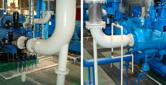

Figure 2. Nonmetallic pipe is installed on two air compressors with built in air-cooled aftercoolers and air-cooled refrigerant dryers. Compressor discharge can be a normal 200 oF with synthetic oil carryover. Failure of either the aftercooler or dryer, plus fouling of the auto drain could endanger system integrity. Note the dead head connection.

The inlet pipe brings air from the filter to the compressor with no pressure loss and should not exhibit any type of interior contamination. The ambient inlet air might well dictate the selection of one type of pipe over another.
During high humidity weather, it’s quite conceivable that condensation will form in the inlet pipe (Figure 6). Therefore, the OEM installation manual usually recommends a drain valve be installed upstream of the compressor inlet. Condensation accelerates coating breakdown, which depends on where the coating is thinnest.
Figure 6. Intake air piping to these centrifugal compressors uses pipe size that is larger than the intake flange. Note the pipe support to floor, the lack of weight on the compressor flange, the condensate drain on intake pipe low point, and the stainless steel wire flexible connector.
Stainless steel inlet piping is an excellent material for large diameter, low pressure inlet air, as long as it’s installed properly and the inside is properly cleaned. Also, there are many grades of thermoplastic material suitable for inlet air piping. I recommend either stainless steel or proper thermoplastic type material for inlet piping in lieu of galvanized piping. Extruded aluminum alloy will work well but, depending on circumstances, might not be the economical choice.
Extruded aluminum alloy tubing can be assembled easily with hand tools to bring a great deal of flexibility to an operating air system or subsystem. This approach is particularly effective for work areas that might have to be rearranged on a routine basis.
