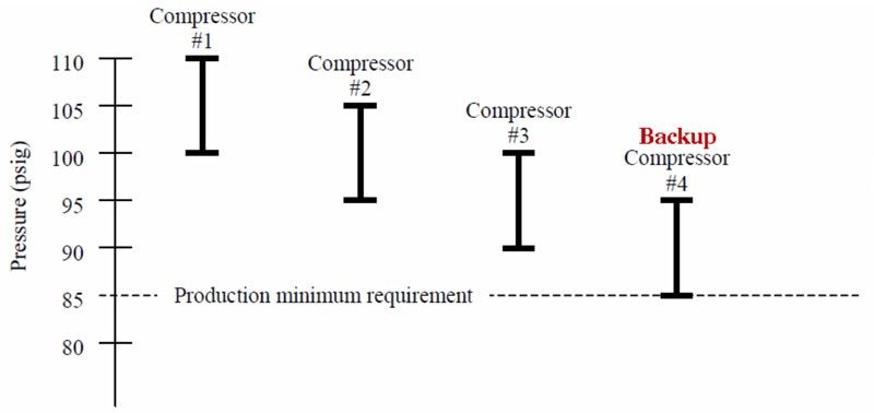

Properly sizing system storage is primary to minimizing these issues and starts with providing for the failure of the largest compressor without having the system pressure fall below the minimum acceptable level at any time. This requires two considerations. First, a backup compressor with adequate capacity must be available and capable of automatically starting. Second, sufficient storage capacity is needed to slow the rate of pressure loss so that the compressor can load up before system pressure drops too low. The size of storage required is dependent upon the size of the largest compressor and can be surprising (Figure 2).
Figure 2: A cascaded control scheme results in higher average system pressure but allows automatic backup to function.
If this setup is applied on a system with four 200-hp 1,000-cfm-rated compressors in a system that has 1,100 gal (10 cubic ft/psi) of storage capacity, the failure of a fully loaded compressor would cause the pressure to fall at a rate of 100 psi/min (1.67 psi/sec). If the spare compressor takes 20 seconds to start and load, system pressure will have fallen about 33 psi before the spare unit delivers any air. If, on the other hand, the system had 10,000 gal of storage capacity, the pressure would have only fallen 3 psi for the same event. With this cascaded control strategy, system pressure will range as high as 110 psi and as low as 90 psi through the normal operating range of the control scheme, which is not preferable but can be managed in several ways, such as a pressure flow controller or an automation system.
