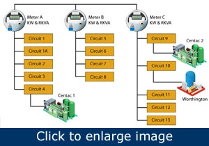

To get the needed data, Thomson-RCA installed an AutoPilot Energy Information System, comprising Opto 22 hardware and software and designed by Holmes Energy. Using analog and digital interfaces that connected Opto 22 I/O processors to field equipment via multiple I/O modules, the Autopilot System was able to monitor 108 I/O points. The monitored machinery and equipment included gas and electric meters, as well as chillers, cooling towers, boilers and water heating equipment. The AutoPilot System also monitored the facility’s compressed air system. This, in turn, enabled tracking of the electrical demand, power consumption, with system pressure, and airflow associated with two 500-hp Centac compressors and one 350-hp Worthington compressor.

In one such experiment, the first Centac compressor required 380 kW, the second Centac slightly less than 350 kW and the Worthington less than 250 kW. Based largely on the data the AutoPilot system aggregated, it became clear that running the Worthington alone on weekends offered the greatest opportunity for savings. In addition to the advantage of the Worthington unit over the bigger Centac units during low demand periods, the AutoPilot system revealed that under all conditions the Centac 2 unit was more efficient than what was thought to be an identical Centac 1.
To reconfigure the operating sequence of its compressed air systems, Thomson-RCA implemented an energy monitoring system.
