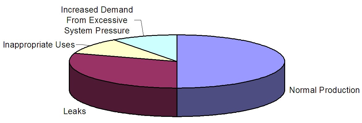

Figure 2. Only half of a typical compressor’s output goes into useful work.
Don’t overlook an analysis of the system’s demand side as it’s the main overall cost driver in producing compressed air (Figure 2). Some tips to consider in looking at your demand side for a new or existing system:
  • List the air uses and their design cfm and pressure.
  • Record the power before and after making any system changes.
  • Benchmark and track overall leak levels. Most air leaks are very close to the end-use equipment.
  • Understand the cost of leaks, identify and fix them, starting with the most significant.
  • Install flow meters on the main supply lines and at specific end uses to facilitate calculating the compressed air cost for a given process or piece of equipment.
  • Operate the system at the lowest possible pressure.
  • Turn off the air to any idled equipment.
  • Verify that compressed air is the best alternative for the application.
  • Install gauges at various points in the main distribution piping to monitor pressure drops.
  • Adjust controls after every change to optimize the savings.
