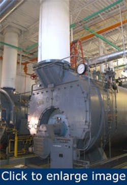

Figure 2. This 600-bhp boiler was being operated during summer only to supply the reheat coils
Every facility manager who operates office HVAC or plant space conditioning systems that incorporate reheat should be on the lookout for the problem shown in Figure 1. Plot the monthly gas consumption for each building or facility to see if you’re burning excessive natural gas during the spring, summer and fall. At the least, spend some time talking with the boiler plant operators. When we visited the plant shown in Figure 2, the first words out of the operator’s mouth were about the craziness of having to operate the boiler during the summer. In terms of energy efficiency, reheat waste is low-hanging fruit, on a par with lighting.
