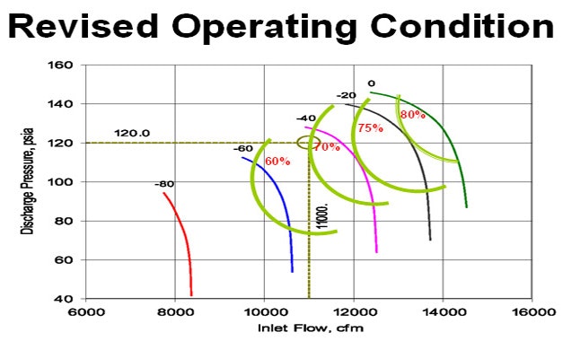

Over time, plant demands changed, which required the compressor to operate at a reduced flow (surge region) and reduced pressure (choke region). The new conditions, plotted in Figure 2, include 11,000 cfm delivered at 120 psi in a 60% efficiency island.
Figure 2. Changing plant conditions moved the unit into the 60% efficiency region.
While the input power has been reduced, this is only the result of operating at a reduced flow and pressure. The full potential power reduction, however, is not realized because the compressor is operating within an island of reduced efficiency. As shown in Figure 2, by Changing the compressor components we have now extended the overall operating range to enable the compressor to accommodate additional reductions in flow and increases in pressure (Figure 3). The change of the existing compressor components has eliminated the need to install a new compressor. The compressor can once again operate in the 80% efficiency island, while reducing the overall power consumption. The difference between operating at 60% efficiency and 80% efficiency is equivalent to 66 horsepower or in this case a minimum of 5% is realized in the overall power consumption.
