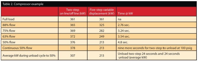

Table 2 is based on a 1,600 cfm 450-hp single-stage rotary screw compressor with a motor that is 93% efficient (361 kW input). The compressor has an operating band of 90 psig to 100 psig and a two-minute blowdown. The full blowdown idle shaft input is 90 hp (75 kW), the effective storage is 3,500 gal and there is a 10-psi loss between compressor and receiver.
Click to enlarge Table 2
With a 12 sec. off time and two minutes required to blow down, the power input will reach approximately 298 kW before the two-step unit reloads. This gives an average kW for the unload cycle of 329.5 kW. Running 12-sec. on/12 sec. off is a serious short cycle problem that burns power and damages bearings, coolers, switches, etc. The five-step control, on the other hand, runs at a continuous 213 kW at 50% load.
At demands below 50%, the five-step unit is in modulation with blowdown (800 cfm) and a 48-sec. idle.
The overall comparison between it and the two-step control varies greatly, depending on conditions. A duty cycle that includes much time below 50% represents a serious misapplication to be corrected.
