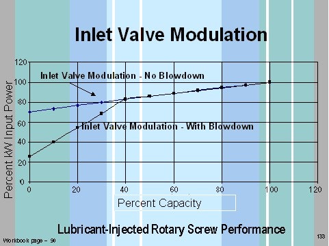

Inlet modulation is inefficient
The load/unload approach was supplanted by a variety of modulation controls that features a gradually closing butterfly valve at the compressor inlet. The weakness in this design is miserly little power savings at part load (Figure 2).
Note that:
  • at 100% capacity, 100% of the power is required
  • at 90% capacity, the power required is 97%
  • at 80% capacity, the power required is 95%
  • at 70% capacity, the power required is 90%
  • at 60% capacity, the power required is 85%
  • at 50% capacity, the power required is 83%
  • at 40% capacity, the power required is 80%
Also note that at zero capacity, 25% power is required. Most compressor vendors strongly suggest using two guidelines. First, when operating multiple rotary compressors, adjust the controls to run all units at full load and use only one for trim for best energy efficiency, and second, operating several inlet modulation control systems at part load is a terrible waste of energy dollars.
