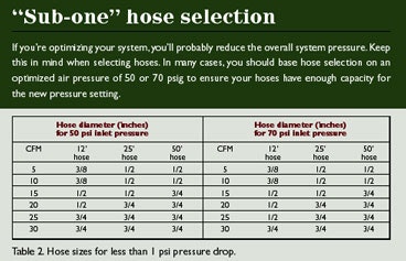

Focus on hoses and disconnects. An easy way to reduce pressure drop even more is by installing larger diameter hoses to get a larger cross section for airflow. Select hose size on the basis of flow rate. Table 2 provides recommended hose sizes for various air flows. It gives hose diameters as a function of inlet pressure that will result in a pressure drop of less than 1 psid for the specified hose length.
Consider upgrading quick disconnects. High-quality, properly sized units reduce leakage and allow unimpeded airflow. Size the disconnect to match the hose selected in Table 2 or 3.
